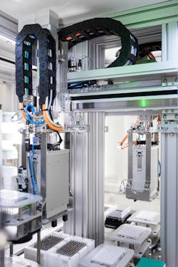

Pipettes about to enter the DNA samples.

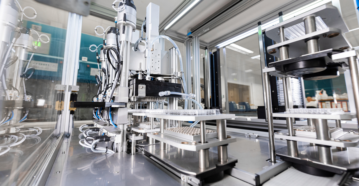

Side-by-side 96 well disposable tip aspirate/dispense heads are used for adding beads and binding buffer to the samples in the first step of the process, as well as doing the final quick wash and elution at the last step of the process.

The DNA extraction on the new Synchron DNA Cruiser begins with a holder that accommodates up to 400 microwell plates—200 for input and 200 for output. A bar code reader scans all the microwell plates at the start of a run. Electric axes, in combination with a semi-rotary drive and a gripper, pick up the microwell plates and place each on carriers that move through the various stations on a simple conveyor system. Metal microspheres are added to separate the DNA from the other material. The DNA attaches itself to the microspheres, while the residual floats up in the microwell plates. Liquid is added to and extracted from the microwell plates at several washing stations. The pipetting head is lowered by an electric slide during this process. After rinsing, clean DNA remains in the microwell plate and is fed to the final processing step: namely, DNA extraction.
The pipetting head for extracting the DNA is handled by an electric axis in combination with an electric slide. There are almost no switching delays between actions. For high data input on the status of components, IO-Link technology is utilized. The control platform for the device acts as a remote I/O system for a master discrete and motion controller.
