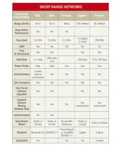

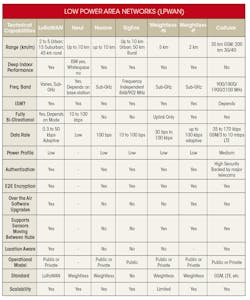

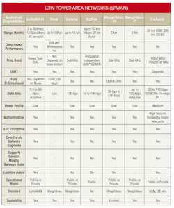

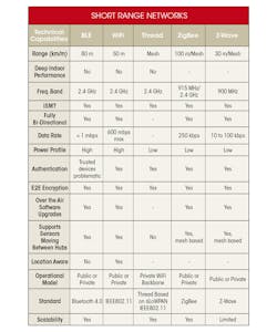

3. Connectivity plays a big role
Many different networks connect physical devices—some are fast, some cost a lot, some can only handle limited amounts of data, and on and on (Fig. 2). Choosing the right connectivity option for a specific use case is very important to the experience a user has with an IoT solution. In some situations, low latency and minimal data loss are very important (autonomous vehicles or volcanic activity monitoring), while in others they are less so (solar generation or tide level monitoring). Regardless of how beautiful a UI is, if the data doesn’t get there when needed, it’ll be wasted.
2. Here’s a rundown of common communication technologies, including their tradeoffs. (Source: “How to choose the best connectivity network for your project”)
Another factor to consider along with connectivity is the fact that many IoT solutions are also located out in remote environments. They often use simple devices that can lose connectivity or miss a few data points quite easily. Some connectivity options are more reliable and that can reduce the likelihood of missing data, but UX design should consider how to respond to the inevitability that some field devices may be offline for a short or long period of time.
A few routes for handling this include: fake it until data gets through, clearly state that the connection is down and data is missing (see the figure below for an example), or indicate that data is in process until it is accomplished. This type of decision will impact UX and should be based on the situation and use case.

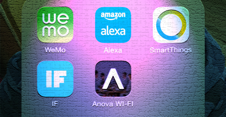

5. Third-party integrations are not seamless
To bring an IoT solution to life, companies almost always need to use components from third-party vendors. Those sensors, processors, controllers, platforms, and applications are likely coming from a variety of vendors, making it difficult to properly integrate them all into a seamless user experience. At the same time, technology is always changing, whether it is older sensor hardware that is replaced or software updated with new patches or versions. The interoperability challenges posed by IoT make great UX all the more difficult.
UX designers should try to incorporate any new components or features into a broader experience rather than creating a piecemeal one. Requiring the user to switch back and forth between two programs or screens will only ruin the user experience.
5. The abundance of smart-home apps that don’t work together leads to a bad user experience. (Source: “For the smart home, how many apps is too many?”)
For example, a smart-home user may operate a smart sound system with one app and smart lights with another, which isn’t a great experience (Fig. 5). In a more extreme example, a smart home may have lighting from several manufacturers that may require the user to operate the lights in a single house using different apps. The ultimate user experience would allow the user to operate each of these devices from within the same app on their phone, tablet, or smart TV. However, this isn’t as easy to accomplish in the consumer space as it can be in industrial implementations.
