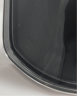

However, this has inherent drawbacks when it comes to precision and final visual aesthetics. The weld depth is typically 1.5 mm and more and therefore causes a relatively large lateral displacement of material known as welding flash. Also, the welding flash might be affected by the heat and fuming from heating platens, and oftentimes stringing could be present during the weld area as the part retracts from heating platen.
With STTIr laser welding, on the other hand, two components are held together under pressure in the final assembled position, as laser light passes through one part (the transmissive surface) and strikes the other (absorptive surface), where the laser energy is converted to heat that melts the interface of both parts and creates the weld with minimum flash and high aesthetics. This modern technology offers numerous advantages in today’s automotive lighting applications.

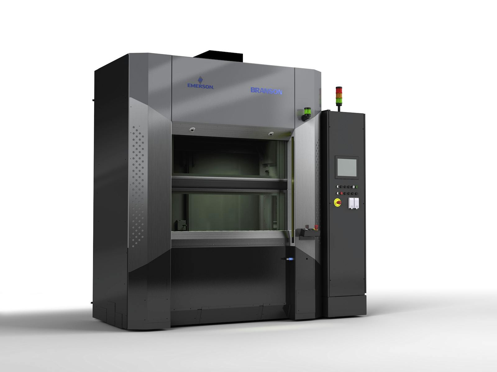

The mechanics of a laser welder are simpler as well. There are only two platens and only one axis of movement, while in hot-plate welding there is the lift table, mirror platen and upper console, all of which have to be moved in three axes. Each of these components can have significant weight and additional power consumption is needed to move them.
