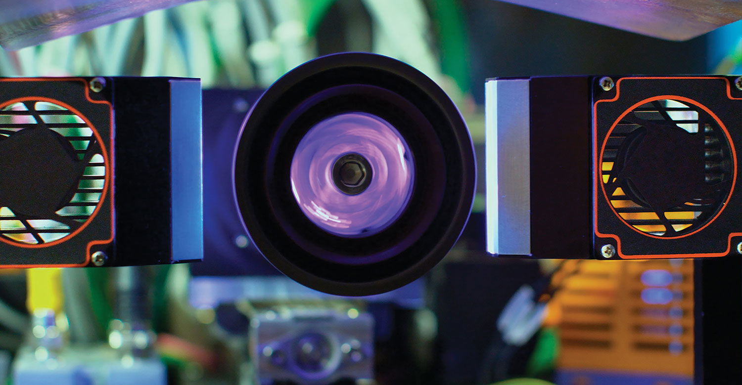

From the conveyor, seals are first moved to the dispensing station where the robotic spindle arm rotates the seal under one of Hernon’s proprietary SureShot 3000 valves. It puts a controlled steady bead of sealant onto the spinning seal. Once the bead is in place, parts are moved to a UV station and inserted into a housing where four high-intensity UV LED lights cure the bead to meet specified exposure times.
The bead of UV FOG is cured in place using lens focused UV LED curing lights. Several  photoinitiators in the sealant are triggered by specific ranges of the UV spectrum to begin the crosslinking process. The end result is a gasketing bead that precisely conforms to the circumference of the seal.
