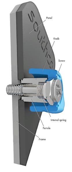

The new 4C Wing Knob captive screws from Southco, Concordville, Pa., can be quickly installed or removed by hand.
Click photo to enlarge
The new 4C Wing Knob captive screws from Southco, Concordville, Pa., can be quickly installed or removed by hand. Their over-molded, distinctively contoured wing-style head design can be used to designate access points through color. The screws make it simple to position sliding components. They come with optional press-in, flare-in, and surface-mount technology for versatility in fastening and unfastening—either by hand or tool—when mounting doors, panels, and other hardware components in applications where space is limited. The fastener features high-strength screws,  hardened carbon steel; zinc-plating, and include a strong, 300-series stainless-steel passivated internal spring. A high-heat-resistant plastic knob withstands SMT installation to PC boards during the reflow process.
