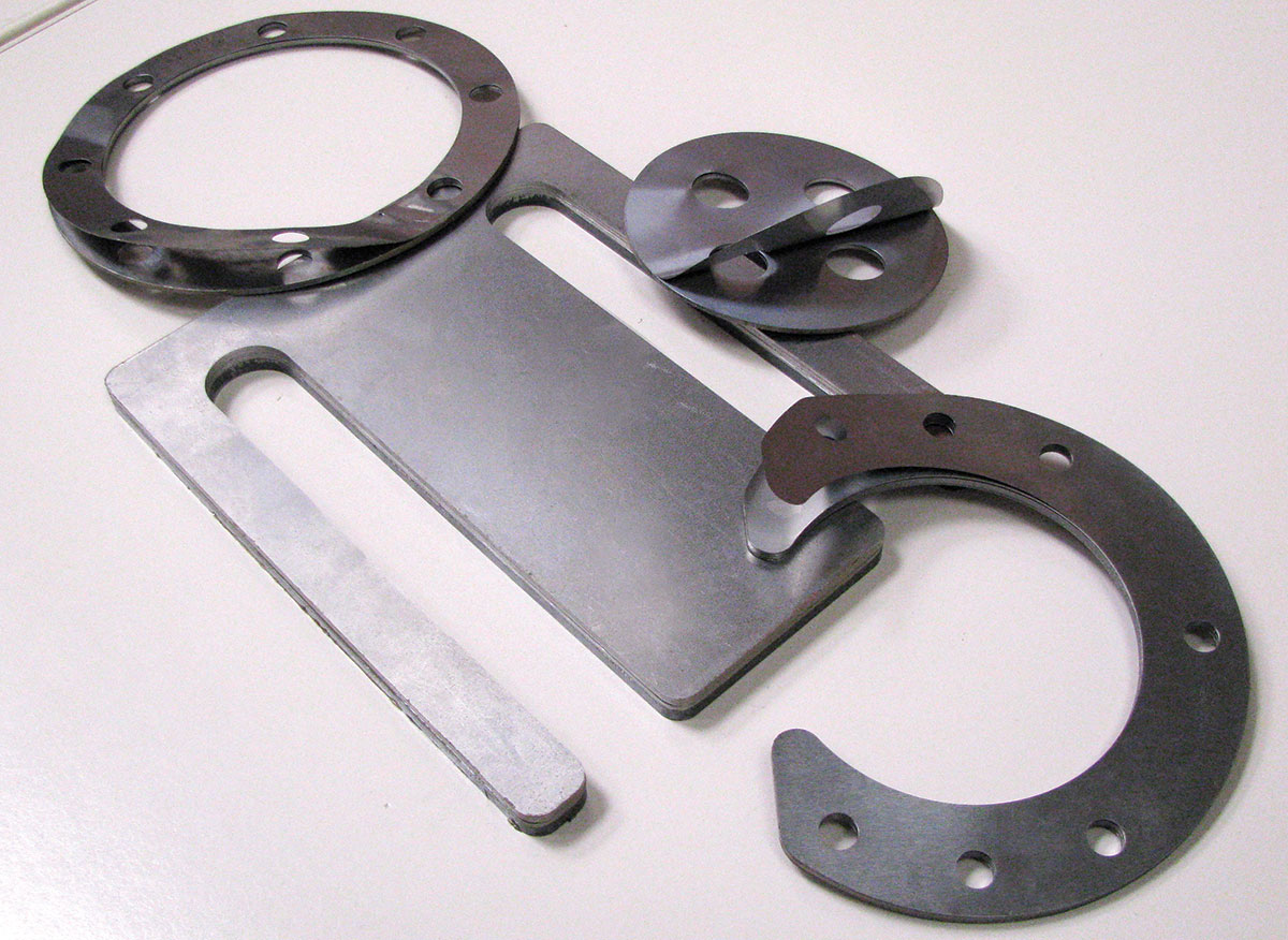

Precision shims compensate for tolerance mismatches and tolerance buildup between mating components.
1. Precision shims, either edge-bonded or laminated, can be made with profiles that match their mating components in the final assembly.

Edge-bonded shims
Unlike surface-bonded laminated shims, the layers of edge-bonded shims are only bonded to layers above and below them at the edges of that layer’s profile. This makes it much easier to separate layers in the field. Because these shim sets are easy to peel, layers that are not needed can be saved for use in a later application.
3. Edge-bonded shims can have layers of different thicknesses to make it easier to adjust the overall final thickness of the shim. And they can be made in a variety of shapes.
Edge-bonded shims have all the performance and cost advantages of solid and loose shims. Another advantage of these shims is that layers of various thicknesses can be combined in a single set, thus giving technicians more flexibility in making adjustments. This is not an option for traditional laminated versions.
Edge-bonded shims also generate additional cost savings because the shim materials are less expensive and removed layers can be reused. And safety is improved because knives aren’t needed to remove the edge-bonded layers. So when adjustment speed, operator safety, and minimizing overall assembly costs are objectives, edge bonded shims provide the best solution.
