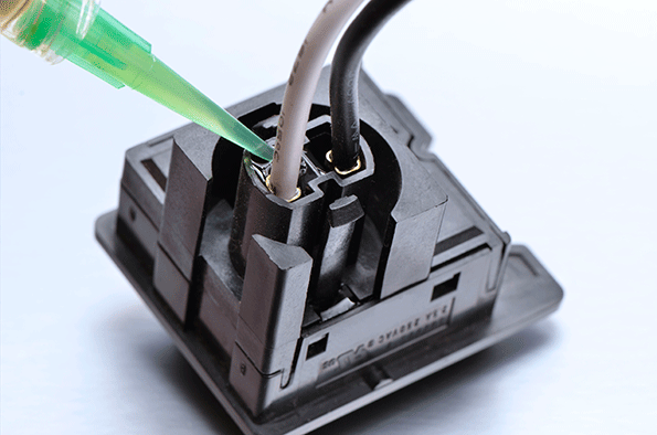

Low viscosity, one-part epoxies like Master Bond EP3RRLV, can be used for high performance potting and encapsulation applications

Ultra-low-viscosity one-part epoxies are widely used for various vacuum impregnation applications, ranging from transformer coils to carbon fiber composites. On the other side of the spectrum, thixotropic epoxies are used to attach dies, and as encapsulants and glob tops. Glob tops are applied to circuits, wire bonds, and even delicate electronic components to provide mechanical support and keep out contaminants.
