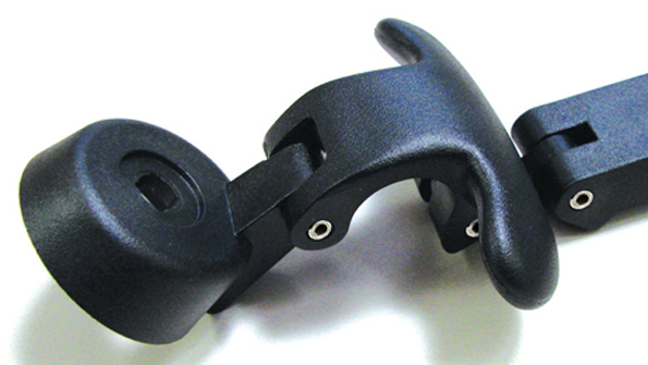

Engineers working on everything from laptops to cosmetic cases to glove boxes commonly use coiled spring-pin hinges because they can tailor them to their designs. They can adjust the “feel” of how a device opens and closes and how far it opens, which affects consumers’ opinion on the device’s quality. Designers can choose between friction-fit versions that hold a position or free-fit hinges that let components swing freely. For example, the hinges that join a laptop display screen to its keyboard are usually friction-fit versions. They hold the screen in any position and do not let it move, regardless of how the laptop is held.
An automotive window opener/lock contains several coiled spring hinges.

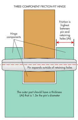

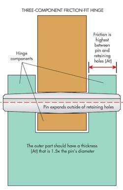

For a friction-fit hinge, there must be spring tension and, therefore, friction, between the pin and each hinge component. But that frictional force is typically greater on one component than the other. So when the hinge rotates (that is, torque applied to either component), the pin remains stationary in one component as the hinge opens or closes. This component is said to be exerting “primary retention.”
To maximize friction in a friction-fit hinge, holes should all be precision matched in terms of diameters. (This is commonly done by drilling or reaming all of the holes in one operation rather than separate steps.) The pin then uniformly exerts tension on all hinge components.

For a typical three-component hinge, the minimum thickness of the outer components should be 1.5× the pin’s nominal diameter. (The nominal diameter is the installed diameter.) But if the outer components’ thicknesses are less than that, then the retention hole should pass through the middle component. And because the pin compresses as it goes through the hole, the end that is pushed through (the sized end), will be smaller than the other (unsized) end. For a free-fit hinge, holes in the outside components should then be set to the measured diameter of the unsized end plus a clearance factor, usually 0.001 in. This usually means a technician will have to put a similar pin through a prototype of the middle component.
