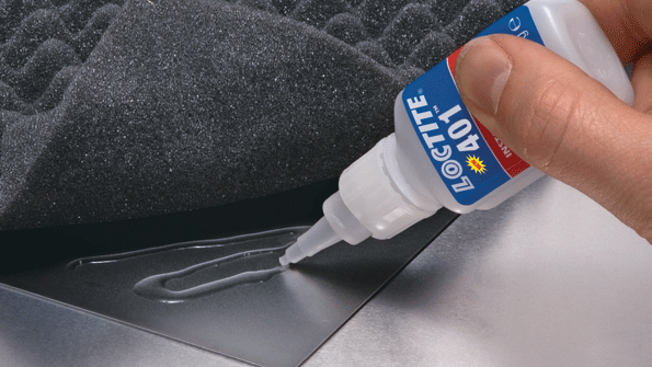

Loctite 401 adhesive is a cyanoacrylate designed for difficultto- bond materials which require uniform stress distribution. It is suited for closefitting applications with metals, plastics, and elastomers.New surface-insensitive cyanoacrylates speed assembly by fixturing substrates such as metals, plastics, and elastomers in 15sec or less. By minimizing the effect of surface acidity and dryness, these cyanoacrylates generally offer the shortest fixture times of all CAs.
