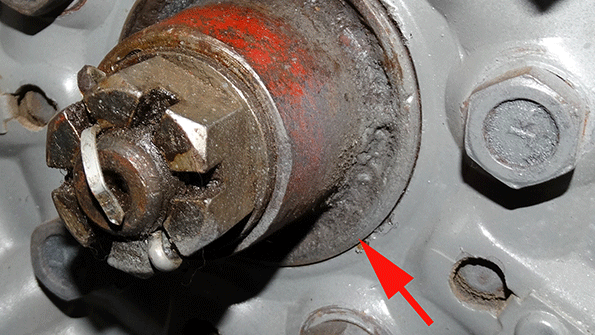

There are two commonly used ways to fasten wheels to a hub: lug-centric and hub-centric. In hub-centric designs (see figure below), the wheel fits snugly against the hub which provides support along with the wheel lugs.
In lug-centric mountings, the wheel lugs center and support the wheel with no support from the hub because of the gap (as indicated by the arrow). (See figures below.)
The easiest way to tell the difference between the two designs is to look at the hub of a hub and wheel assembly. If the hole in the center of the wheel fits snugly against the hub, then it is hub-centric. If there is a gap between the center hole of the wheel and the hub, then it is lug-centric.
