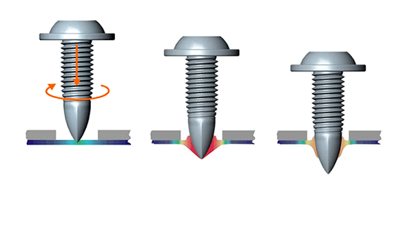

The FDS screw employs “flow drill screw driving” technology to pierce the upper and lower layers of aluminum and create an extruded boss in the lower layer. The screw then forms a metric screw thread in the newly extruded boss and is tightened to develop the desired clamping load that pulls and holds the joint tightly together.
During installation (see figure above), the first stage involves rotating the screw at up to 5,000 rpm (Step 1). The combination of high rotational speed and geometry of the special point locally heats the material into a plastic state, facilitating both the piercing of the upper sheet (Step 2) and forming the extrusion in the lower sheet (Step 3). Once the point is through, the screw uses its thread-forming region to create threads in the sheet and extruded boss (Step 4). After threads are formed, the material stack behaves like any other tapped-nut member. The screw is finally torqued to a predetermined level which safely develops clamp load without stripping the joint (Step 5 and Step 6).
