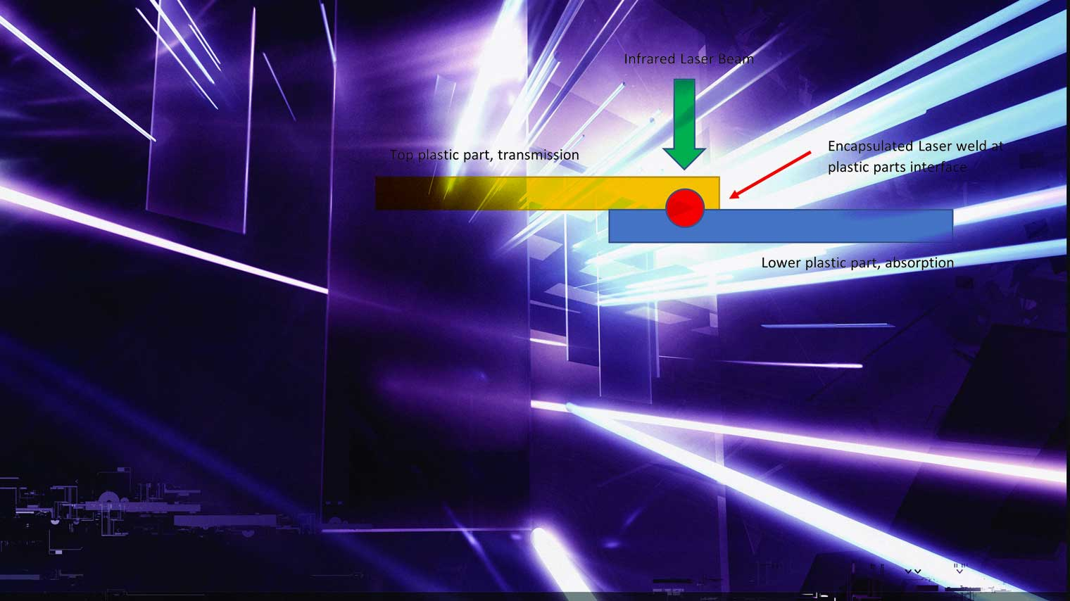

Laser welding diagram superimposed over laser background

Non-contact laser welding offers several advantages when it comes to joining one plastic part to another. It works on the principle of partial transmission which lets a laser’s light travel through one of the plastic parts to create heat and fuse or weld it to a second plastic part. The finished weld is contained between the parts. There is also no contact between the fused area and the heat source or atmosphere, so the finished joint is clean. Conventional plastic welding techniques such as ultrasonic and hot stamping, on the other hand, require contact with the outer surfaces of the parts being joined, and this can contaminate the joint and the parts’ surfaces or mechanically damage the assembly.

2. Can the laser beam efficiently travel through the top material to the joint interface? And can the bottom layer absorb the laser beam to create heat where it’s needed?
Laser beams for plastic welding are usually created by high-powered diode lasers and are in the near-infrared and infrared regions (wavelengths ranging from 800 to 2,000 nm). Plastics being welded together must have some degree of transmission and absorption in this range.
Plastics have amorphous and crystalline phases simultaneously. Differences in a plastic’s refractive indexes in these phases cause scatter and reflect light, as well as transmit and absorb it. This can help or hinder laser welding, depending on the level of these effects. Designers can tailor these properties in plastics to get the right amount of laser beam transmission through the top part and absorption in the lower part.
For example, the design team can put additives in plastics to make them absorb more laser light. And adjusting the concentration of glass fibers in plastics such as polyamide (PA-66, aka nylon) changes the amount of light transmitted through them.
