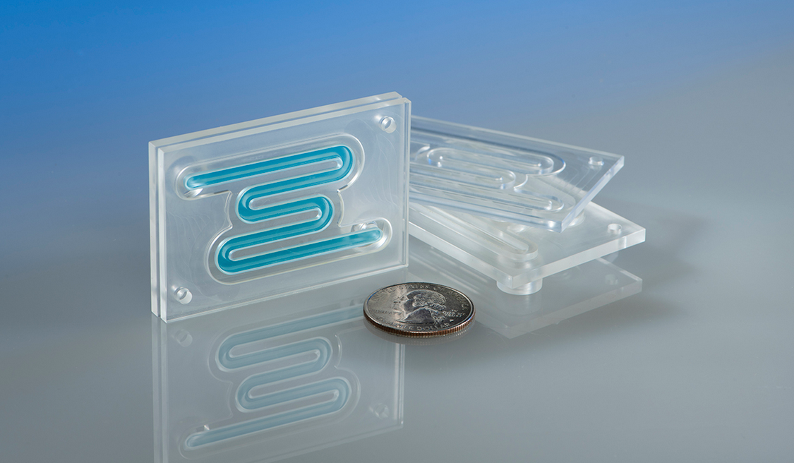

Typical targets include the interior surface of tongue-and-groove joints and the interior surfaces of a “double V” joint on one of the mating parts. Precisely depositing the absorber within enclosed joints like these focuses the laser-generated heat needed to create the part-to-part melt and creates a “flash-trap” that contains the melt’s treated area, isolating it from any nearby microfluidic flow paths in the finished assembly.
This new method of plastic laser-welding reliably produces complex fluid paths while maintaining superior aspect ratios in the submillimeter flow path pitch. Such precision is essential for microfluidic parts, which must be reliably bonded, yet maintain consistent dimensions along extremely small flow paths.

A typical example of the process is its use on two clear plastic “coupons” or  injection-molded parts that mate to form a serpentine flow path like those found in a host of medical devices. The coupons will become the “absorptive” half of each assembly, so they are placed in the spray deposition equipment for a coating of the laser absorber.

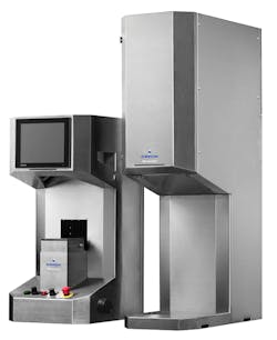

From there, parts are transferred to the laser welder (see photo above), which makes a clear-on-clear, laser-welded part. For medical or IVD devices that demand optically clear flow paths, the technology is invaluable. It simplifies everything from automating blood cell counts in capillary-sized fluid paths to providing visual validation to technicians that a microdose of a powerful therapy is being properly administered to a patient.
