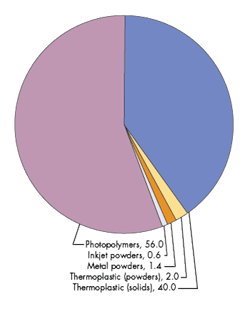

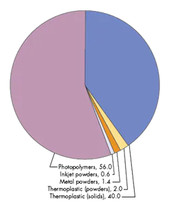

Created in 2013, this chart shows the breakdown of different materials and why there may be so much focus on processes like stereolithography (SLA) and fused filament fabrication (FFF) that use photopolymers and thermoplastics.
Photopolymers
With new processes like digital light projection, and recently, Carbon 3D’s way of processing parts at greater speeds, photosensitive polymers may quickly gain more popularity. In 2013 they were already over half the 3D printing material’s market. Photosensitive polymers are liquid plastics that solidify in ultraviolet (UV) light. Often used in stereolithography (SLA) and jetting processes, the materials are generally good for form, fit, feel, and looks.

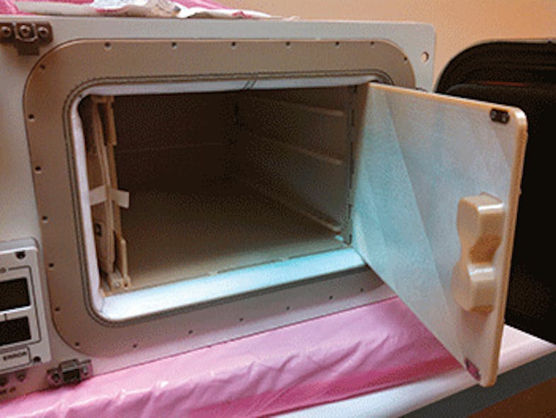

This is a look at the Polar Freezer developed at the University of Alabama at Birmingham. The interior, printed from ULTEM 9085 in a single piece, is able to withstand temperatures of –112˚F.
Another product garnering lots of attention is Stratasys’ Ultem. The polyetherimide has a tensile strength of about 16.5 ksi and a glass transition temperature of 422˚F; a typical ABS maintains about 5 to 6 ksi and 221˚F, respectively.
Ultem’s applications are wide-ranging, even venturing into more abstract areas like the Polar—a low-temperature freezer on the International Space Station (ISS) that’s used primarily to transport test samples to and from ISS. Multiple pieces of the interior shell and the cold temperatures required by the freezer made many materials, and processes, inefficient. Thus, engineers turned to Stratasys’ ULTEM 9085 with a FFF, which simplified the construction of the product by printing the inner shell in one piece. Machined polyether ether ketone (PEEK), a semi-crystalline phthalonitrile, was another material considered for this project. This can be difficult to 3D-print, and machining it yielded a less effective product. When designing with high-end materials in high-end applications, even a little change can make a major difference.

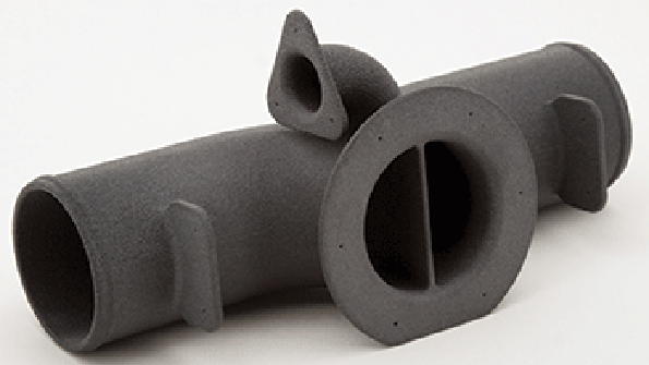

This is an example of the complex, load-bearing, low-water-absorption shapes that are possible with OXFAB carbon-filled PEEK. This part was 3D-printed in a sintering process (Credit: Oxford Performance Materials Inc.)
That didn’t stop the Naval Research Laboratory (NRL) from continuing their researching around PEEK, though, such as studying PEEK-like phthalonitrile resin compositions. Teddy Keller, section head of Advanced Materials for the NRL, says, “When considering new materials, you first think of cost, then how it can be processed. Finally, you find a way to process it with what you have available. Properties, such as viscosity, can sometimes be altered to help improve the window a material can be processed.”
