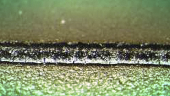

The operating conditions, including circumferential speed, temperature, pressure, and lubricant as well as internal and external contamination are determinative for the lifespan of an RSS. An excessive temperature increase can result in unfavorable changes in the mechanical characteristics of the sealing material. It can also lead to the hardening of the seal lip or to cracking in the seal lip contact zone and can result in the seal’s premature malfunction.
Advanced oil carbonization and axial cracks.
High temperature increases can accelerate the oxidation rate of the medium to be sealed or activate its additives to develop undesirable reactions to the material in the seal/shaft contact zones. Even with the use of chemically resistant sealing materials, the sealing mechanism can be disrupted by the byproducts of oil additive reactions or from coked oil deposits in the contact area of the sealing lip. The temperatures that act on the RSS are the result of environmental influences and the frictional heat caused by the seal lip itself. This leads to a considerable increase in the seal gap temperature compared to the oil bath temperature–the so-called overtemperature. For this reason, RSS materials are always selected for their appropriate temperature, oil resistance, and capacity to achieve the best possible specific sealing behavior with the least possible contact pressure. Friction-optimized seal lip geometry leads to the reduction of frictional heat generation, and to a decrease in the overtemperature in the seal lip contact zone, which has a direct impact on operating life.
