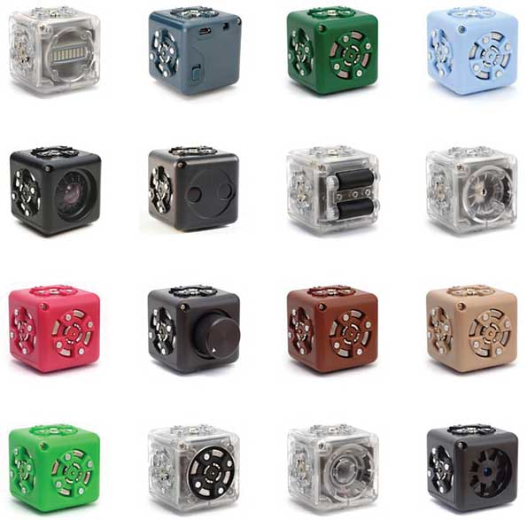

Hiller: In 2010, Modular Robotics announced Cubelets, magnetic blocks that can be snapped together to create robots without using wires. Each Cubelet contains a computer that performs different tasks. For example, there are blocks that contain a motor, battery, or a sensor that responds to light, temperature, and sound. Together, they enable the finished robots to perform complex tasks.

The image above shows the available Cubelets blocks that can be used to create robots that move, have proximity sensors, detect light, and changes in temperature.
