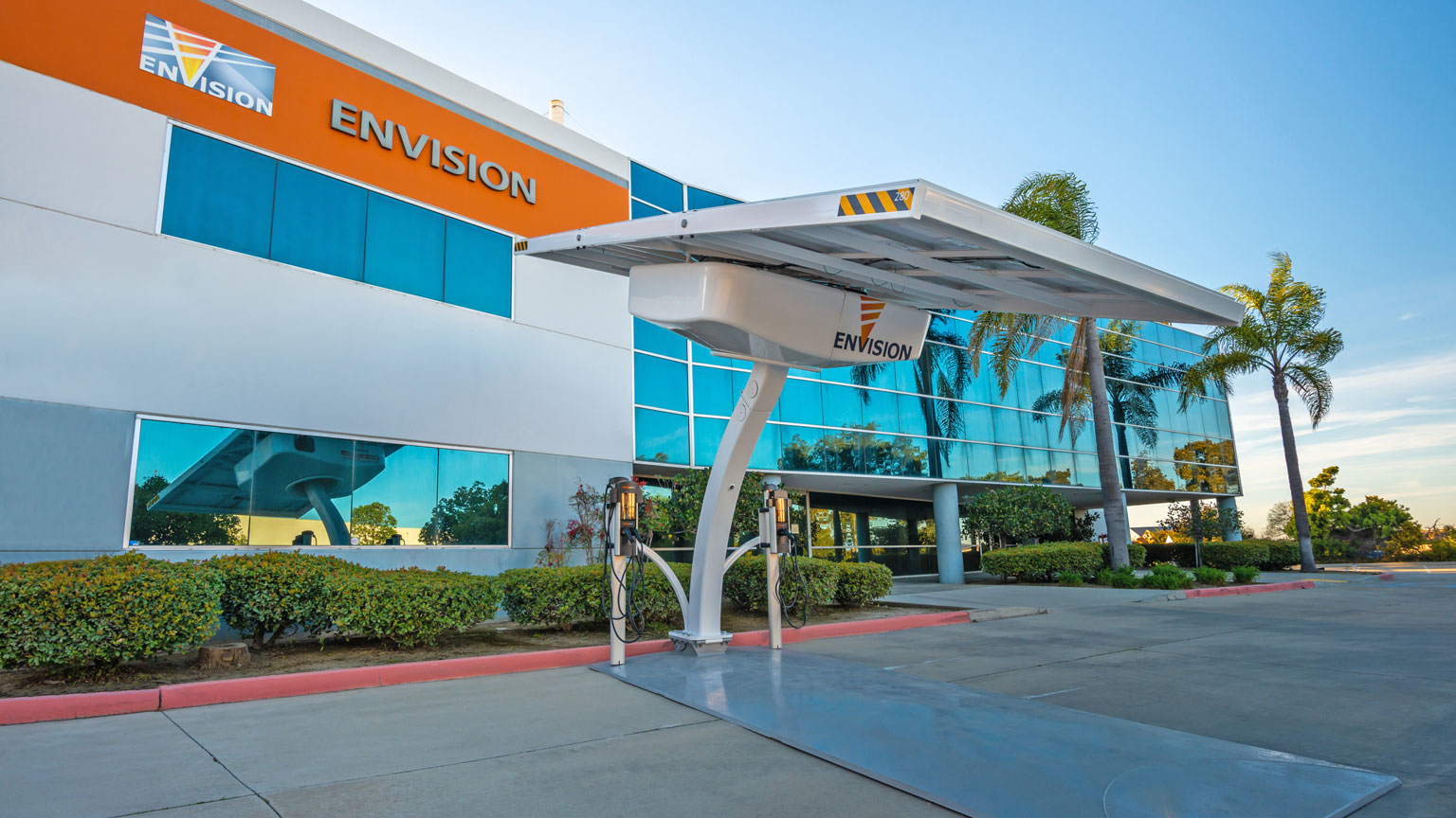

Making all-electric, mobile, off-highway equipment viable is a complicated engineering proposition. One of the key building blocks of such an approach is devising a way to recharge the vehicles’ batteries. Using a diesel generator doesn’t make sense when one of the overarching goals of the all-electric concept is to come up with a greener approach with a minimal carbon footprint.
When our company Envision Solar decided to tackle the challenge, building what we called the Electric Vehicle Autonomous Renewable Charger or EV ARC 2020, we identified two major issues. The first was making sure it would operate in all climates and conditions. The second was ensuring it would operate at maximum efficiency while remaining simple and reliable.
Here’s how we addressed these issues.
Passive Thermal Management
Engineering a mobile charger that operates in all climates, from the chill of winter in New York to the hottest afternoon in the desert of Nevada, is not trivial. It would have to work in extreme conditions and when there was no sunlight to energize the solar panels. That meant it would also have to store energy to use anytime, which leads to batteries and all the complex equipment needed to manage them, as well as the associated electronic for storing, inverting and delivering usable electricity to the vehicles and tools our customers used.
Batteries and the associated electronics operate most efficiently and safely within a specific range of temperatures we refer to as the Goldilocks Zone (not too hot, not too cold—just right). Fortunately, that range is broad, starting at 32 (0) and ending at just below 104 (40). Typically, the means to maintain any object at a somewhat constant temperature is to heat it when it’s too cold and cool it when it’s too hot. However, these energy-intensive processes would create an unacceptable parasitic draw on a limited source of electrical generation (solar power). Using all the energy generated from the solar array to maintain the Goldilocks Zone would make it impractical. We had to engineer a product that could passively regulate its own temperature.
The second law of thermodynamics and entropy were conveniently available to us. The question was how to leverage them to our benefit, when it was a benefit, and reduce their impacts when they worked against us. The second law of thermodynamics says hot objects are constantly getting cold (giving up heat energy and moving towards a state of entropy). This law is why ice cubes melt (as the ambient heat moves towards them) and hot soup cools (giving up heat to match ambient conditions). Keeping soup warm in a cold environment is simple; insulation does the trick. Thermoses are not intelligent, but they are good at slowing down the second law of thermodynamics. Cooling soup in a hot environment is quite a bit more complicated, as any child who has impatiently blown soup from their spoon onto the table can attest.
In the end, we combined three passive methods of cooling—convection, conduction and phase changing—to handle hot conditions. For the cold, we reduced airflow, added insulation and used the heat generated by EV ARC’s normal operations. All together, these methods let the charger operate anywhere in the U.S.

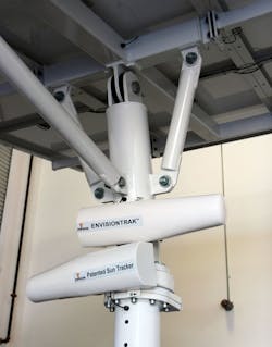

Solar Tracking
The next challenge we had to overcome was more basic and involved the fundamentals of solar power. It boils down to maximizing efficiency. There are two ways to do this: make the panels larger, or make them denser in terms of the number of power-producing cells per inch. Enlarging the solar panels was never an option because the EV ARC had to be mobile and fit in a single parking space. This meant we had to somehow increase the energy density, or at least the effective density of the solar array.
The time of day with the highest energy density is typically around noon (or thereabouts) when the sun is at its highest point in the sky. This lets photons hit the array as perpendicularly as possible, maximizing its production. To get more “noon,” we had to add solar tracking. It keeps the array properly aimed toward the sun during the as much of the day as possible. This, in effect, shifts noon and extends the window of maximum effectiveness.
There was already a great variety of tracking technologies on the market ranging from extremely basic to extraordinarily advanced. However, the more advanced the technology, the more complex it becomes. Just as in many fields of engineering, complexity increases the likelihood of failure and increased costs.
We also found out that photovoltaic cells are fairly insensitive to pointing accuracy. In fact, you get most production gains by keeping the modules within 20 deg. of pointing directly at the sun. Any more accuracy leads to significant increase in complexity, risk, and cost but only a marginal increase in electrical generation.
We soon settled on a simple and highly robust tracking solution that would provide almost all the gains with a far lower likelihood of failure. Our engineers devised simple but sufficient tracking algorithms to control the most reliable hardware in a patented EnvisionTrak solar tracker.
EnvisionTrak tilts the array to keep it aimed toward the sun. But rather than swinging or rolling the array, as is common with most tracking devices, we effectively bend the column atop which the array sits. This is vital for parking because while the column reorients the array, it constantly maintains the array’s alignment with the parking space no matter where the vehicle is pointed.
Swinging the array would have it encroaching on adjacent parking spaces, or worse, the driving lanes (which is illegal if it’s also a fire lane). The subsystem lets the panels generate 25% more electricity than a fixed array, and more electricity means miles driven or hours of equipment operation.

The EV ARC requires little space (just a parking space worth) and no construction at all. It is delivered to site, ready to operate and gets moved to the next job site as soon as it is no longer needed at the first. Because it generates and stores all its own electricity, it can charge at any time—not just when the sun is shining.
Because EV ARC is mobile and will travel and be used in a wide variety of places, it had to comply with equipment regulations and structural codes in any jurisdiction…essentially everywhere. So, the array could not be too large, though it needed as many photocells as possible.
