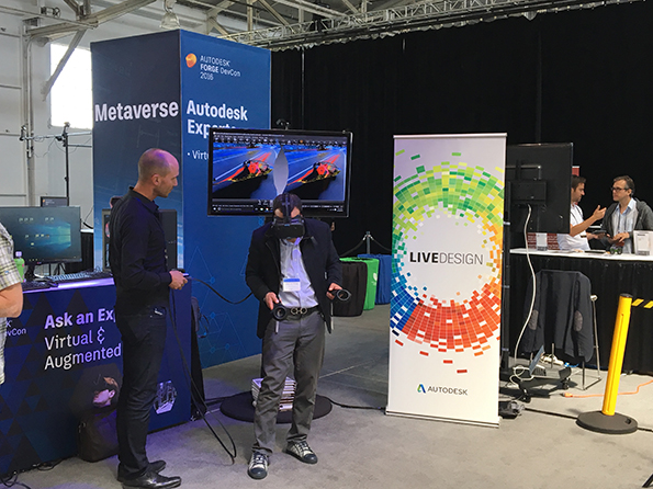

Attendees at the Autodesk Forge DevCon were able to try the HTC Vive headset and step inside different environments including an apartment and a racing car.
There are two types of computer-generated simulation. The first is virtual reality (VR), where a person is completely immersed into a simulated world. Via the headset, their vision is completely replaced by the computer simulation that sometimes also affects their hearing or touch. Products like the Oculus Rift, the Samsung VR, and the PlayStation VR, along with the HTC Vive, are starting to be used by the gamer community, which feels like a natural fit. Using VR will completely immerse players into the gaming world. The headset is a bit jarring at first. You completely lose sight and perspective of your outside real surroundings (which is the point). Once the program is turned on, I was placed inside an apartment. With the two hand controllers, there are a variety of commands at your disposable. I could change the material of objects like the floor from wood to tile. I would also point at objects and move them around. One option gave me the power to teleport anywhere within the apartment, which caused me to almost fall when I jumped back after having teleported too close to an imaginary wall. The next program let me examine a race car. I was not able to drive the vehicle, but I was able to change the body, the color, and take a cross-section of the vehicle. While using the cross-section feature, wherever you place the control will be sectioned and you can move the control through the body of the car. This progressively reveals more of the internals of the car such as the engine and driving controls.
