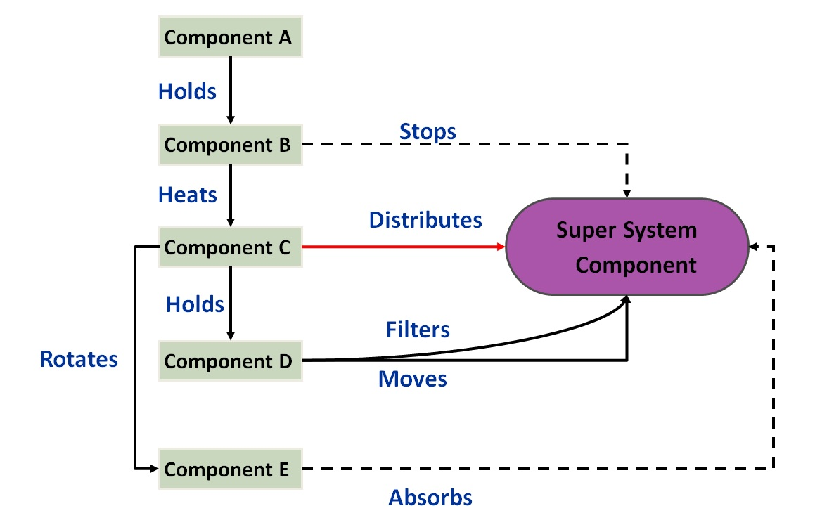

The figure below illustrates a simple function model consisting of five system components and one super system component. The functional relationships between these various elements are shown with various arrows and functional tags. In this scheme, solid black arrows are useful functions performed at the correct level. Dashed black arrows are useful functions performed either insufficiently or excessively. The red arrow is a harmful function. It is rare that a system doesn’t have at least one or, more typically, several harmful functions or useful functions performed at the wrong level.
Flow Chart for Functional Modeling
Once you construct an accurate function model of a target system, it becomes a simple matter of looking at each harmful or useful functions not performed at the required level and asking: “Would customers pay more for our product if we could [fill in the blank]?”
For example, using the model above and substituting “dust” for “Super System Component”, the questions becomes: “Would customers pay more for our product if we could stop the distribution of dust by Component C?” Answers to these types of questions may not be obvious, but the power of this approach is that each hypothetical new product offering can be tested in the market using conventional Voice of the Customer techniques. Thus, instead of asking your marketing team to ask prospective customers open-ended questions such as, ”What new features would you like to see in our product?”, they can explore and test specific product ideas.
