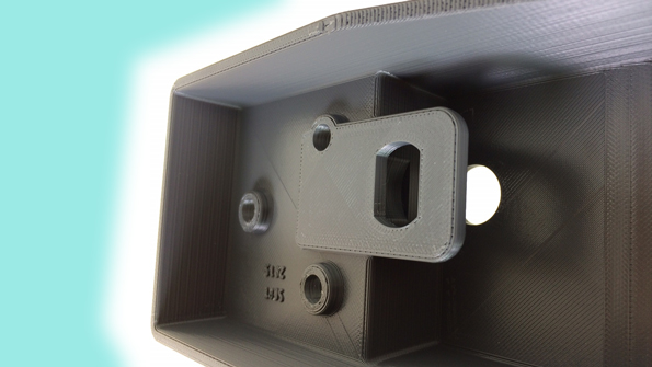

Another application for our 3D printer that accounts for about 30% of its usage is printing end-use parts for our manufacturing operations. This is done for several reasons, including fast turnaround, ease of design, ability to add extra features, lower costs, and it’s just plain cool to make your own functional parts! Machinery guards are one area we make a lot of parts for. 3D printing lets us make belt guards with odd shapes, going around corners, with integral mounting bosses and belt replacement info printed on them. I have found this to be much easier and faster than coming up with a sheet-metal or fabricated design. Sensor brackets are another kind of part we print quite often. Photoeye mounts, limit-switch mounts, fiber-optic tip brackets are all fair game. It’s easy to include ambient light shielding, and pick up existing mounting holes.
4. This photo clearly depicts a part with multiple features in a single part from a single printing. It’s important to exploit this feature of 3-D printing to get the most cost and time benefits from the technology.
