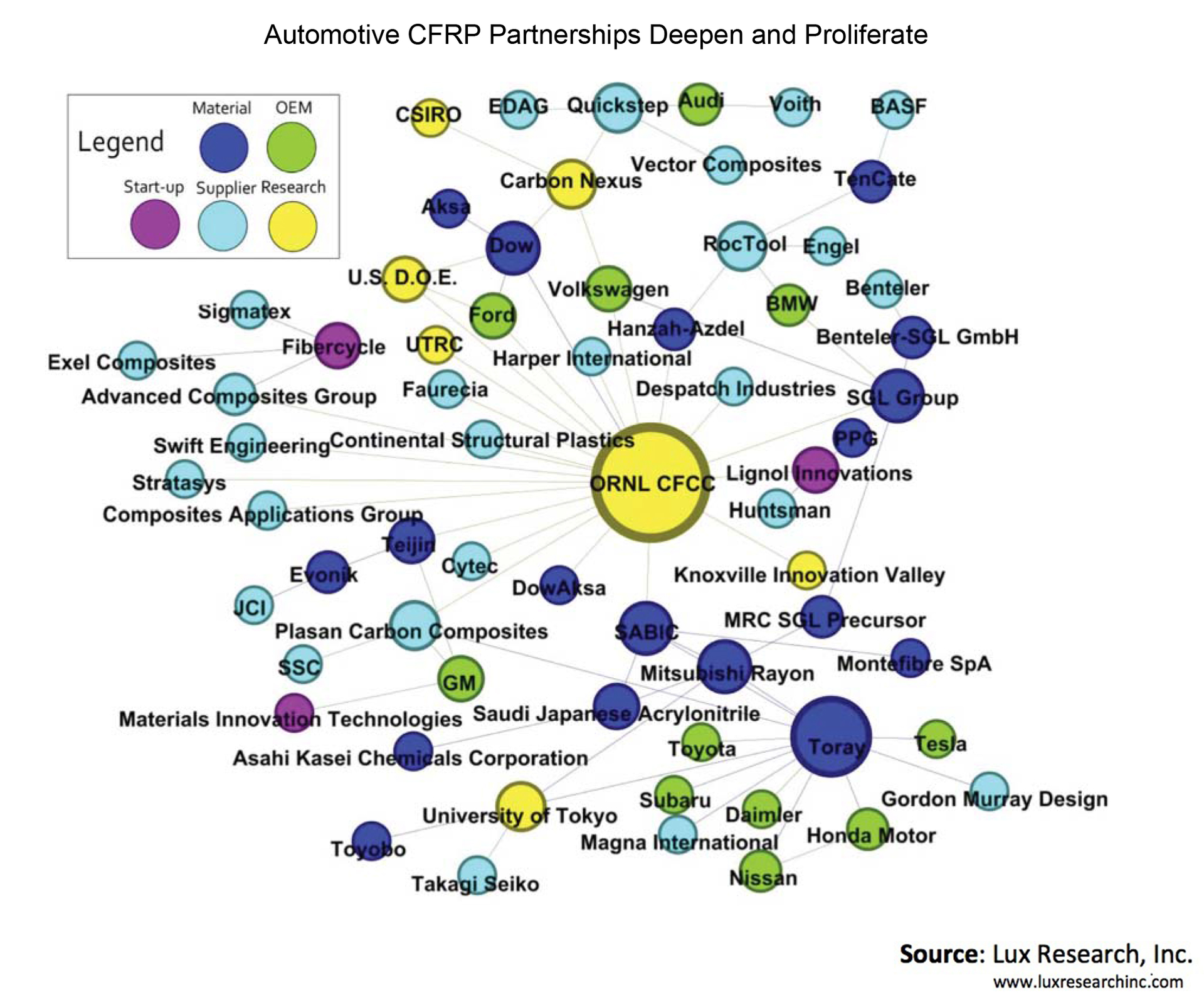

As a result, most major automotive companies and carbon-fiber producers are forming partnerships, joining consortia, and conducting research to bring automotive CFRPs closer to commercial reality. Oak Ridge National Laboratory’s (ORNL) Carbon Fiber Composites Consortium remains the most connected entity on the automotive partnership map, with 23 OEM, Tier 1, and major material supplier partners. ORNL’s Carbon Fiber Technology Facility, a 25-ton/yr. pilot carbon-fiber production line is exploring methods of making fiber at lower costs. The facility demonstrated two years ago that it can turn out standard modulus carbon fibers—with tensile strengths of 500 ksi and modulus as high as 36 Msi—using textile-grade polyacrylonitrile (PAN) precursor. ORNL says it costs less than one half as much as fiber-grade PAN.
Today, ORNL faces competition from Carbon Nexusan’s 20 ton/yr. pilot production line established by Australia’s Victorian Centre of Advanced Materials Manufacturing. Carbon Nexusan, partnering with Dow, Quickstep, Volkswagen, and Australian national research agency CSIRO, is developing its own alternative precursor, tensile strength improvements, and energy-efficient technologies, many of which could be used with ORNL’s methods. In addition to advances in fiber production, suppliers throughout the value chain are developing faster, more efficient equipment, resins designed for automotive CFRP use, and scalable CFRP recycling methods.
Among auto companies, BMW stands out as a pioneer of CFRP use. It first invested in carbon-fiber maker SGL in 2009, a relationship that continues with BMW investing $200 million more just last year to push production capacity from 6,000 tons to 9,000 tons/yr. BMW will use the materials in its i-Series electric and plug-in hybrid cars, which are currently rolling off production lines at a rate of 100 cars per day.
