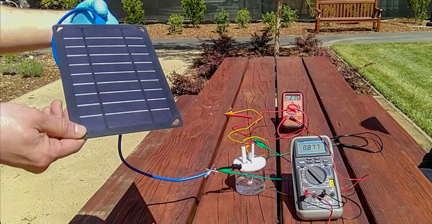

The team members conducted most tests in controlled laboratory conditions, where they could regulate the amount of electricity entering the device. But they also designed a solar-powered demonstration machine that produced hydrogen and oxygen gas from seawater collected from San Francisco Bay. Without the risk of corrosion from salts, the device matched electrolysis methods that use purified water.
