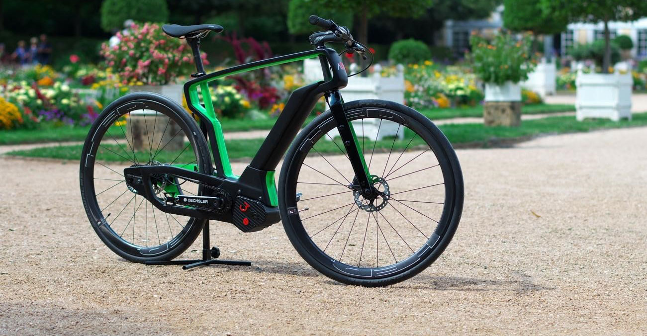

The AREVO carbon fiber ebike with high impact resistant thermoplastic matrix is shown in the Hofgarten in Ansbach, where the automatic drive was developed by OECHSLER AG.
