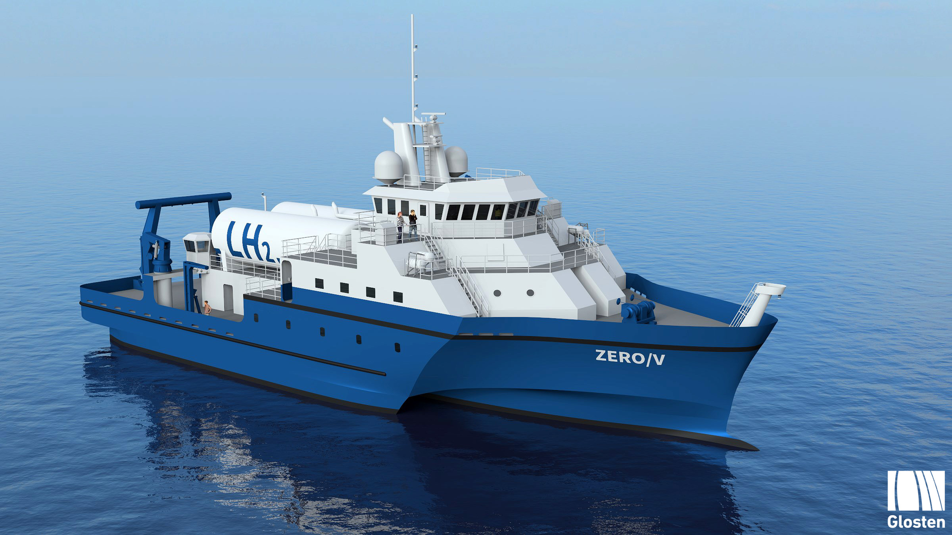

Zero-V would also need to store onboard heavy hydrogen tanks while accommodating at least 18 scientists, 11 crew members, and three labs. To partially solve the overcrowding problem, the ship will use a trimaran design with three parallel hulls, typically used for high-speed boats. The design offers a great deal of space above deck for hydrogen tanks, in addition to adequate below-deck space for berthing and science instruments and machinery.
