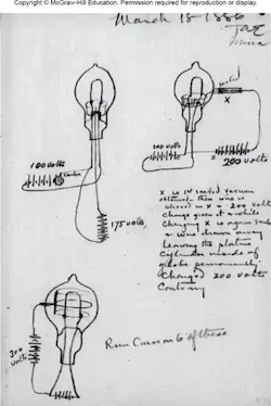

When solving any design problem, it is essential that engineers keep track of the ideas developed and decisions made in a design notebook. Some companies require engineers maintain these, with every entry signed and dated for legal purposes. Then, if a patent is applied for or defended against infringement, there will be complete documentation of the birth and development of the idea. A notebook with sequentially numbered, signed, and dated pages is considered good documentation; random bits of information scrawled on bits of paper are not. Successful engineers, such as Thomas Edison, keep good design notebooks.
A page from Thomas Edison’s designer notebook.
