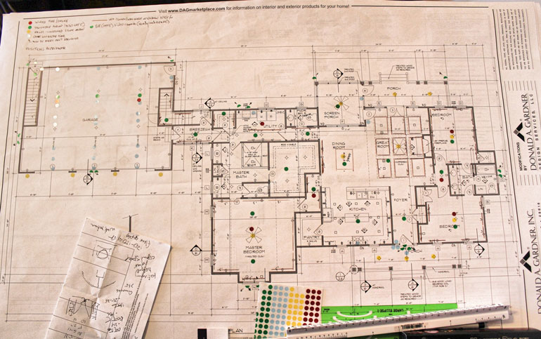

The example house in this article comprises approximately 3,450 feet2 on a site in the Central Savannah River Area (CSRA) of South Carolina, near Aiken. The chart lists some of the costs, including the 40-year total cost of ownership, compared to the same costs for a traditional 21st century house. (The data comes from veteran custom homebuilder Don Cerra, who’s earned a reputation as the “Greenest” builder in the CSRA).
