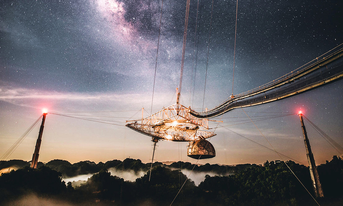

The radio/radar telescope at the Arecibo Observatory in Puerto Rico was a 1,000-ft diameter dish nestled in a valley, with 900 tons of electronic gear hanging 450 feet above the dish suspended by cables from three towers.
Last August, an auxiliary cable slipped from its socket and tore a 100-ft gash in the reflector dish. Then in November, while an engineering team tried to devise a plan for repairing the damage, a three-inch main steel cable snapped. The team soon discovered that the main cable failed at about 60% of its estimated minimum breaking strength during calm weather. This led them to suspect other cables could also be weaker than expected. Apparently they were right, as the dish collapsed on Dec 1.
After the second cable failure, an engineering consulting firm came in and determined that given the risk of more cable failures, repair work on the telescope would be unsafe. Even stress tests to get more data on the remaining cables were deemed too risky. The firm eventually recommended a controlled demolition to eliminate the dangers of an unexpected collapse.
Two other consulting reams were hired to assess the situation. One thought stabilization was possible and needed to be done immediately. The other agreed that there was no way to safely verify the structure’s stability and advised against letting anyone on the telescope’s platforms or towers.
The National Science Foundation (NSF, which owns the telescope) and the University of Central Florida (which manages its day-to-day operations) had decided to play it safe and demolish the 57-year old structure. Demolition engineers were working on a controlled decommissioning that could involve helicopters and explosives, before it self-destructed.
