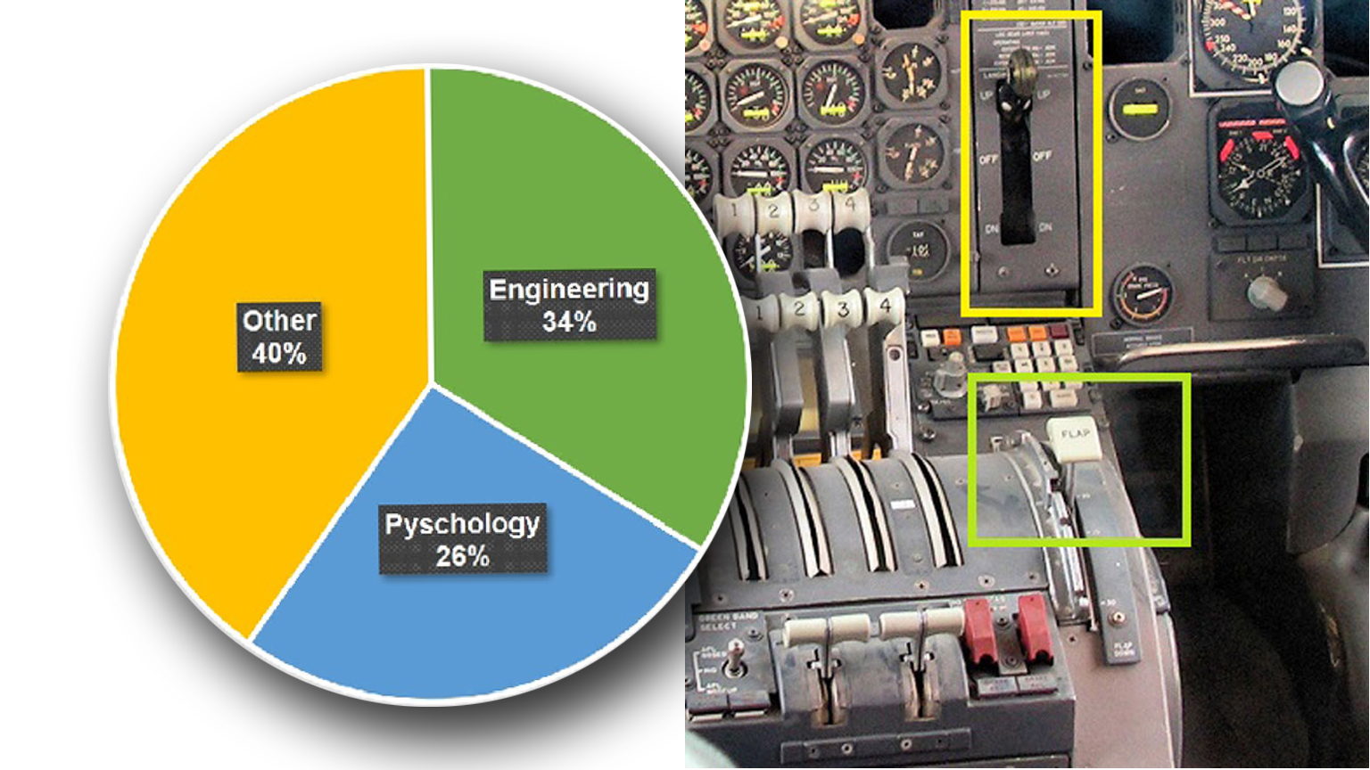

Aircraft controls. In the U.S., HF engineering began as a response to poorly configured aircraft controls that led to catastrophically high pilot-error rates during World War II. Well-trained pilots were crashing planes by mistakenly raising the landing gear just after safely landing.
Analysis revealed that pilots were confusing the flap controls with the neighboring landing-gear controls which were similarly shaped. Instead of retracting the flaps immediately after landing, pilots were accidentally retracting the landing gear, making the plane crash on the runway.
In response, the Air Force rigorously trained pilots to avoid the problem. But accidents continued. Instead of designing machines to fit the pilots, the Air Force tried to train pilots to fit the machine.
Alfonse Chapanis, a pioneer in HF engineering, was called in to examine the problem. He soon recognized the cause: the landing gear and flap controls were too close to each other and almost identical in look and feel.
He had the control knobs redesigned so pilots could easily feel the difference between them, and their shape hinted at their functions. The handle for the landing gear was shaped like a wheel, while the one for the flaps was shaped like a flap.
This redesign was immediately adopted and the number of crashed went down dramatically. In hindsight, this simple solution might seem obvious. The key was to address the pilot, controls, task and environment as a complete system. Complete systems work more safely and effectively when all components are evaluated together and designed around the user.
Chapanis’ redesign set a standard for landing gear and flap controls that is still used, giving pilots visual and tactile clues.

By its nature, HF engineering is multidisciplinary. University-level education programs—typically at the graduate level—tend to be housed in either the industrial engineering or psychology departments, and often span these two. This mix may seem odd to the outsider, but the discipline evolved from roots in psychology (focused on perception, cognition and memory) and industrial engineering (focused on workplace design, efficiency and productivity). That said, people tend to find their way into the profession from a variety of educational backgrounds including computer science, physiology, biomechanics, cognitive science, medicine and a variety of engineering disciplines.
