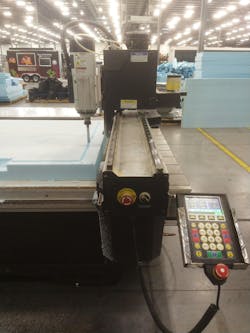

  • Machines. 3 Axis CNC Router, AXYZ Infinitive 4010 ATC / Multicam 3000 Series
  • Operations. 3 axis mill operations

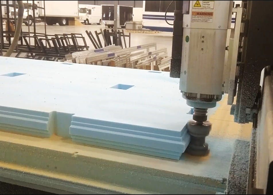

To manufacture the WIC (walk-in cooler) parts, 2D contour and pocket operations were mostly implemented to create the variation of geometries required to interconnect the parts.

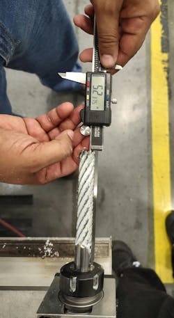

As for tooling, four tools were used: two form mills (male and female profile), one straight cutter and a 60 deg. chamfer.
Following is an overview of two of these tools:
A straight cutter is used in 2D contour operation, following the model outliner to define a true edge around the part. (See figs. 8 and 9 below)
Additionally, it is used for pocket operations on more complex parts such as door jamb header/legs or corners.
A form mill is used in 2D contour, defining the final male profile. (see figs. 10 and 11 below).
