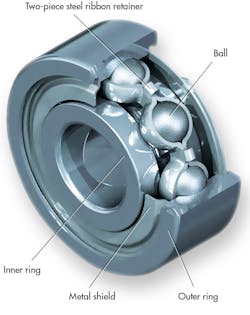

Bearing life
Bearing life is traditionally calculated as follows. After selecting the appropriate type of bearing for a given application, the next step is to determine the size. Knowing the loads and speeds, or duty cycle, the bearings will experience in the application, the catalog load ratings are used to calculate the basic rating life. This is then compared to the desired design life to determine appropriate sizing.
Cross-sectional view detailing the components in a typical bearing.
However, in the case of extreme or harsh environments, the basic rating life is adjusted downward as conditions dictate. In some cases, the life adjustment factor is as low 0.1. This means that, because of environmental conditions, only 10% of the calculated rating life can be assumed.
In these cases, an engineer may have to design custom bearings to help offset the negative impact of the environment or operating condition. The parts of the bearings that can be changed out or custom made include materials for rings and rollers, coatings, seals or retainer materials, and lubricants.
