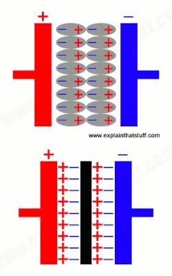

2. A capacitor (top) aligns the molecules of a dielectric across an electric field to store energy. A supercapacitor (bottom) aligns the charges of an electrolyte on either side of an insulator to store a double-layer charge.
A capacitor consists of two or more conductive plates separated by a dielectric. When an electric current enters the capacitor, the dielectric stops the flow and a charge builds up and is stored in an electric field between the plates. Each capacitor is designed to have a particular capacitance (energy storage). When a capacitor is connected to an external circuit, a current will rapidly discharge.
In a supercapacitor, there is no dielectric between plates; rather, there is an electrolyte and a thin insulator such as cardboard or paper. When a current is introduced to the supercapacitor, ions build on either side of the insulator to generate a double layer of charge. (See figure 2.) Supercapacitors are limited to low voltages, but very high capacitance, as a high voltage would break down the electrolyte.
