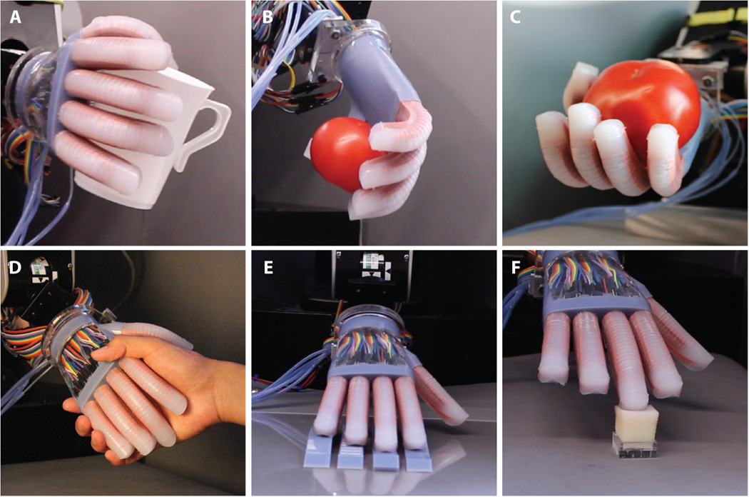

Researchers at Cornell University designed a flexible optic waveguide that serves as a force and strain sensor in a soft robotic hand. The hand can quickly and accurately detect textures, alter its force on delicate objects, and continuously track its path of motion. One of the many demonstrations of the robot's performance was to pick the ripest tomato from a bunch of 3.

The researchers at Cornell integrated their haptic sensors into the soft robot, which uses pneumatic actuation to mimic the fluid motions of a human hand. The sensors were integrated into the top and bottom of each finger to sense bending, and into the fingertips to sense forces.
