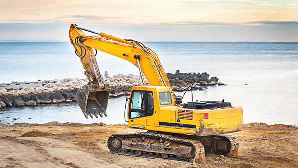

Engineers developing heavy equipment such as tractors, cranes, wood chippers, and construction equipment need to include incline sensors and indicators—both to ensure that workers do not operate the equipment in unsafe locations and to prevent their equipment from tipping over during use. They also have to be assured that the sensors will work despite vibrations and shocks (common conditions for off-road equipment).
Many pieces of heavy equipment need inclination sensors to keep operators and the machine safe from falling over. Should those sensors be capacitive or thermal based devices?
