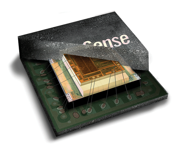

A gyroscope and accelerometer are printed on a single die, and then a magnetometer is assembled on the back of the die. This allows one package to detect multiple forces in the physical environment. Sensor packages can reduce size and cost while offering more features. (Credit: Invensense.com)
