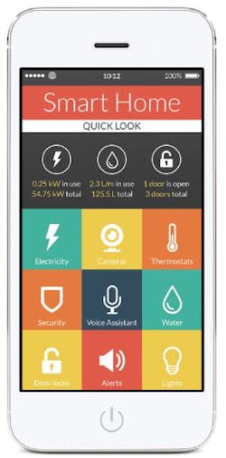

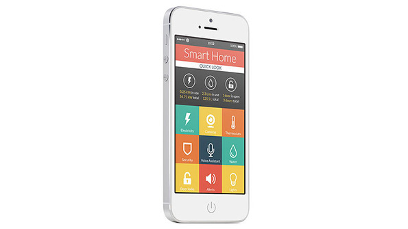

The latest smartphones are Bluetooth Smart-Ready, letting them monitor and control sensor nodes with a low-energy radio.
Bluetooth is also often less expensive and more compact than other wireless technologies and is based on standards included in virtually all smartphones and tablets shipping today. Beyond access to the smartphone’s well-accepted user interface and high-performance processing, Bluetooth extends their use to new opportunities and features based on the fact cell phones are carried by so many people and are available to so many more.
For instance, a cell phone connected via Bluetooth Smart can serve as an authentication “key” to unlock a user’s front door or verify that an operator has been trained on a particular piece of equipment prior to unlocking it for use. Additionally, Bluetooth Smart-enabled cell phones can provide location-based services to deliver specific content of interest to consumers as they enter a store or go near a display table, clothing rack, or digital sign.
It could also be used by a factory manager touring the factory floor and wanting production numbers for an assembly line or an update on quality data for outgoing shipments. In short, using the smartphone or tablet user interface leverages what is already available to most people.

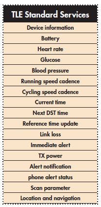

The Bluetooth SIG has adopted 36 standard services and profiles for generic attribute or GATT-based BTLE, and they are listed at www.bluetooth.org. In some cases, several services are used to create a profile (shown in Table of Profiles).
There are some services or parameters that might be more helpful to engineers such as pump pressure, voltage, or flow. However, until those services are developed, designers can still use any of the services applicable to their designs, confident that they have been well thought out and vetted by teams of Bluetooth SIG engineers. All applications should be able to use the Device Information service, and many can use the battery, time, and alert notification services. And after a smartphone application identifies your equipment, it can read the device information and “know” which profiles your design supports.
