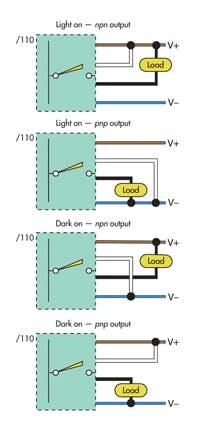

Some sensors detect where the electric load is and whether a machine’s controls need pnp or npn operation. The installer can set the sensor to operate light-on (top) or dark-on (bottom) with a turn of the potentiometer.

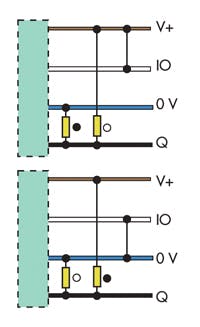

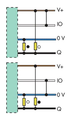

    This push-pull output electrically switches to light-on or dark-on by tying the white wire (I/O) to either the brown (+UB) or blue (0 V). Inverted channels are also available.

    Some push-pull-based sensors generate four different outputs, thanks to “4-in-1” circuitry. A user adjusts the sensor’s potentiometer to the mode that suits the application. Circuits in the sensor detect which output the controls need. Such sensors connect loads in light-on or dark-on for one wire, and V+ or V– for the other. That way, users only have to stock one sensor for a given application (instead of four models to cover the same outputs).
    For example, 4-in-1 photoelectric sensors can operate light-on or dark-on plus automatically detect output load and sink or source output accordingly, to operate in pnp-light-on, pnp-dark-on, npn-light-on, or npn-dark-on. In light-on mode they trigger output when a target is present (low to high), and in dark-on mode they trigger output when no target is present — and drop out once objects are detected (high to low).
