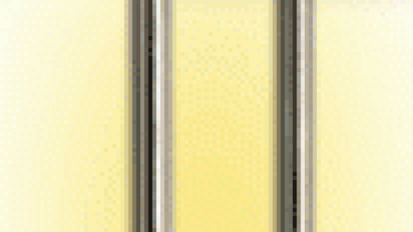

M12 and M8 micro DIN-enabled temperature sensors combine a compact, secure, and vibration-resistant connector with thermocouples and Pt100 resistance thermometers.
Features & benefits
  • Available off-the-shelf with either stainless steel or Inconel sheath, 3 and 6-mm diameters; standard lengths of 200, 500, 750, 1,000, and 1,500 mm
  • BSP, NPT, and metric mounting threads; Tri-clamp flanges for hygienic and vacuum applications
  • Easy installation and maintenance; meet IEC and ANSI standards; IP67-rated
  • Termination through polarized connector, secured with a hand-tightened knurled nut
  • Applications include industrial, hygienic, food and beverage, pharmaceutical and research labs
