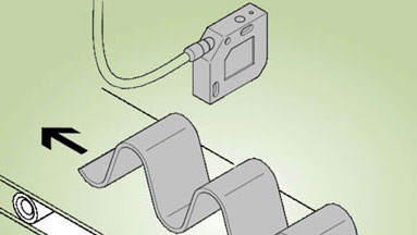

Consider a distance-sensing application in which the objective is to sense the distance between the sensor and a contoured workpiece. The taught-in contour coordinates already reside in the central PLC and distance measurements are taken on each new workpiece to meet quality specifications. At points where crests are detected, a metal saw precisely trims the contoured workpiece.
Once the sensor position is fixed and crest points are taught into the sensor, detecting the crests becomes a repetitive task. Such sensing techniques deliver a high degree of accuracy, with displacement resolution of 0.001 mm common today.
