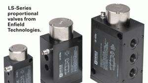

Typical servopneumatic (and most servohydraulic) position control systems consist of a double-acting cylinder, full-scale linear position sensor, high-speed proportional 5/3 (5-port, 3-position) valve, and a suitable closed-loop controller. The controller receives a target setpoint command signal and a sensor feedback signal, and based on its algorithm, communicates a plan of action to the valve. From an end user standpoint, however, the controller and the valve can be treated as a “black box” component: The user simply inputs a command signal (target position, velocity, or trajectory) and the cylinder moves accordingly. Typically, this command signal comes from a PLC and is in the form of voltage (0 to 10 Vdc) or current (4 to 20 mA).
The proportional valve (or in some cases, servo valve) undoubtedly plays the central role in the overall system. Even though it has three discrete “positions,” it can infinitely vary its effective orifice size, essentially controlling the “extend” and “retract” cylinder speeds. The valve's high-speed feature means that it can change the size of the orifice almost instantly. By quickly and accurately changing valve positions (cylinder direction) and orifice sizes (cylinder speed), any cylinder position can be obtained and maintained. This is where the controller comes into play.

JR • Enfield: The most important aspect for correctly setting up a servopneumatic system is sizing. The cylinder bore size must be carefully selected for the required dynamics, and the valve must be sized according to the flow requirements of the system. The two most common mistakes typically made when setting up a system are undersizing the cylinder bore relative to the system dynamics, and oversizing the valve relative to the cylinder size and dynamics, either of which usually results in an uncontrollable system. Here is a good step-by-step example of how to size a position control system using servopneumatics:
  1. Determine the maximum controlled acceleration required.
  2. Based on total moving mass, determine the force required to provide the acceleration (F = m•a).
  3. Select a cylinder bore size that can provide at least twice the force required (ideally, much higher) based on the line pressure and bore area. The higher this force margin, the more controllable the system becomes, and as such it may pay off to approach a margin of 10 if the space permits it. It's useful to keep in mind that the force increases exponentially with respect to the cylinder bore: To double the available maximum force, one needs to increase the cylinder bore by only 41%. Similarly, by doubling the bore size, the available maximum force increases by a factor of four.
  4. Based on the maximum target linear velocity, determine the maximum airflow that will be needed in SLPM (standard liters per minute - SI units) or SCFM (standard cubic feet per minute - Imperial units). Most valves in the U.S. and European markets list their flow specs in at least one of these two units.
  5. Select a proportional valve that can handle the required flow rate calculated in step four. In general, it is better for controllability to undersize rather than oversize.
