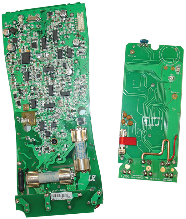

The fuses on an industrial meter are typically sized to prevent arc flashes in the event of an accidental short (left). There is only one fuse on the inexpensive meter purchased at a retailer (right) and it is inadequate for arc flash situations.

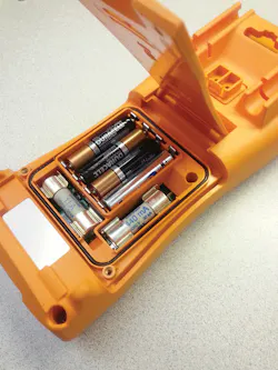

Examine the way inexpensive meter cases are assembled and you’ll typically find the case halves held together with self-tapping screws. The problem is that batteries and fuses are in the case. Repeated entries to service them can become tedious. High-end devices, such as the Agilent U1273A, use a separate battery door that is O-ring gasketed and fastened with machine screws. This sort of attachment technique gives the device an IP54 rating for dusty and wet industrial environments. Few meters go this far.

Industrial meters such as the Agilent U1273A may provide access to batteries and fuses through a special battery door. It is not uncommon that inexpensive meters force the user to completely disassemble the case as a means of accessing the batteries and fuses.

HHDMMs sometimes get used for dangerous tasks. One of the most notorious is the testing of industrial power circuits that have enough electrical energy to create a lethal arc flash. And accidents can happen. Suppose an operator inadvertently connects to either of two amp jacks on the meter instead of the voltage jack. This action could short circuit the industrial power line, potentially causing a lethal arc flash. Commercial and residential circuits have circuit breakers to protect against these accidental short circuits. But the circuit breakers and fuses in industrial circuits do not provide this kind of protection. They are set at much higher fault energy levels. It is up to the meter to protect the user from this kind of lethal error.
Handheld digital multimeters made today all tend to have block diagrams that are similar. But some of the most important meter features concern ergonomics and safety. These don’t show up in block diagrams.
When configured properly, the HHDMM has a high input impedance that will block the high-energy voltage for safe testing. And in meters like the U1273A, one can see two specialty fuses behind the battery door, each protecting one of the two ampere jacks. Fuse makers actually designed special fuses just for this task. The fuses are small enough to fit inside an HHDMM but are capable of interrupting high-energy arc-flash fault current over 10,000 A. These fuses are special and expensive. There are no cheap import substitutes for them. Hobbyist HHDMMs do not offer such protection. That’s why inexpensive hobbyist HHDMMs should never be brought into industrial environments.
