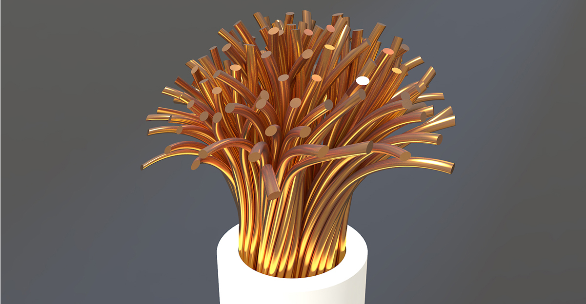

Highest Flex Capability: While flat cable is inherently more flexible than round cable, there are differences in the flexibility among flat cables.
Fine Base Strands: If flexibility is important, look for a core of the finest base stranded wire.
At the core of Cicoil flat cables is the finest base stranded wire, typically two to three times as many finer strands than used in competitive “flexible” wire. Eliminating unnecessary insulating, fillers, and tapes reduces the bulk and physical volume of flat cables. In addition, their low profile enables them to hug surfaces and take advantage of tight or normally unused space. A rectangular cross-section allows flat cables to stack, or layer, with almost no wasted dead space between cables, providing maximum conductor density for a given volume.
