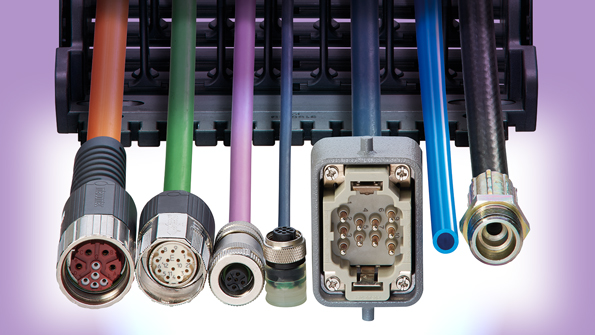

Cable carriers keep cables, as well as pneumatics, electronics, and hydraulics, safe and out of the way. But there are guidelines on how those cables and lines should be positioned in the carrier to get the most out of it.
Interior Separation
Interior separation is crucial for getting maximum service life out of cables and hoses being held in cable carriers. Cables and hoses with different diameters and outer jacket materials need to be laid out separately using modular separators. A minimum clearance between cables, hoses, and the cable carrier should also be maintained. This clearance should not exceed 1.5 times the diameter of similarly sized cables. Moreover, when a cable carrier begins to move back and forth faster and more frequently, the exact positioning of the cables and hoses inside becomes more important.
Cramming as many cables as possible into a carrier simply won’t work. Cables can become permanently deformed and “corkscrew,” or become entangled with one another. If cables with different outer-jacket materials—for example, PVC and PUR—are placed side by side, they can wear against each other and become “stuck” together or cause abrasion and damage. All of these scenarios can lead to premature failures.

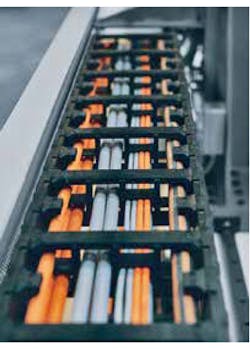

This illustration demonstrates the two rules of distribution, with the larger hoses sitting side by side and the smaller hoses separated by a wall so they cannot get tangled up.
Rule 1: D1 + D2 > 1.2 × hi
where D is the diameter of cable one; D2 is the diameter of cable two; and hi is the inner height of the cable carrier. Then, If D1 + D2 > 1.2 x hi, no separation is needed between the two cables/hoses. Two cables or hoses should never be left unguided on top of one another or be allowed to become entangled.
Rule 2: d1 + d2 ≤ 1.2 × hi
If d1 + d2 ≤ 1.2 x hi, a vertical separator or a horizontal shelf must be used to reduce the inner height, thereby preventing the two cables from getting entangled.
It’s recommended that the minimum clearance between a cable and the walls and top of its cable carrier should be at least 10% of the largest cable’s diameter (or 20% for hoses).
