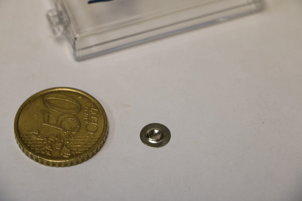

Rupture disks have gotten smaller as demand for lighter and smaller versions grows.

Going Small
For decades, rupture disks usually ranged in size from 1 to 6 in. and were used in a wide variety of applications: petrochemical, aerospace, defense, medical, railroad, nuclear, chemical, pharmaceutical, food processing, and oil field. When needed for larger piping applications, the disks can be as large as 60 in. nominal size. To install the disks, they are held in place with a device called a safety head and mounted between flanged pipe ends (see image below). The safety head seals the rupture disk into the piping system with its required dimensions and seating arrangement, thereby getting the best performance from it.
A forward-acting burst disk before and after activation.
However, manufacturers making parts and assemblies for vehicles and other transportation equipment have increased their focus on making vehicles lighter to conserve fuel. This means they want smaller, lighter rupture disks, increasing the demand for disks well under 1 in. in diameter.
