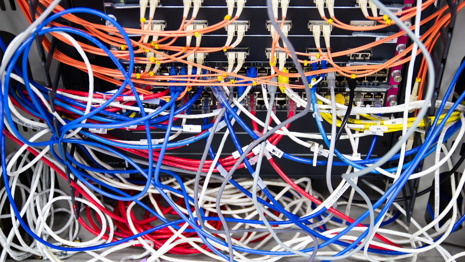

Piyaphun Juntraverot/Dreamstime
Cable network in server room
