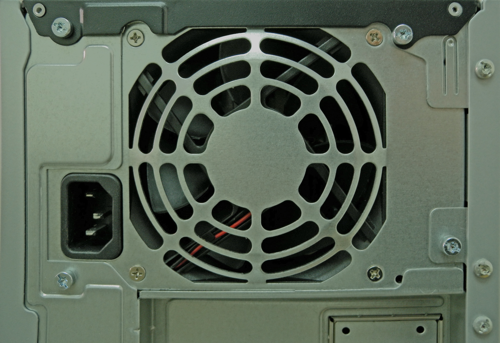

Simply knowing the cubic-feet-per-minute requirements is not enough when choosing fans.
Several factors come into play when estimating the size of cooling fans needed to keep electronics cool inside enclosures. Here’s a look at a step-by-step process for roughly sizing fans based on the task they must perform.
