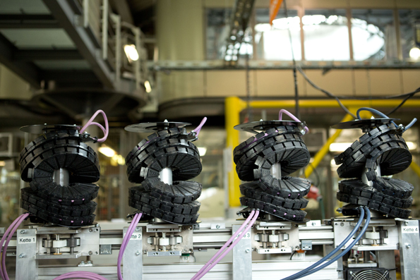

One test motion cables undergo at cable maker igus inc. is repeated twisting. Here, cables sit inside Twisterband cable carriers, which rotate thousands of degrees per cycle.

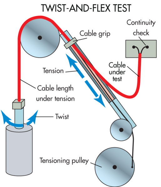

Cable makers often simulate the twisting and bending action that motion cables typically see through a twist and bend test. The typical approach is to put a cable sample under tension while twisting it 360° in clockwise and counterclockwise directions while simultaneously monitoring cable resistance for evidence of shorts or cold hardening.

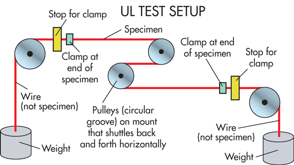

UL 1582 specifies a test for cable flexing that runs lengths of cable back and forth over two pulleys. But it stops after 15,000 cycles. Makers of motion cable may run similar tests but typically extend the duration to millions of cycles.

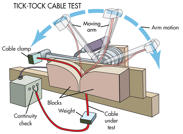

Some cable makers adapt a tick-tock mil-standard test for judging flex life in motion cables. The original test ran for thousands of cycles; makers of motion cable extend that number into the millions. The test consists of repeatedly bending a length of cable back and forth over blocks while hanging a weight on the opposite end. A continuity test checks for cold hardening by measuring cable resistance.

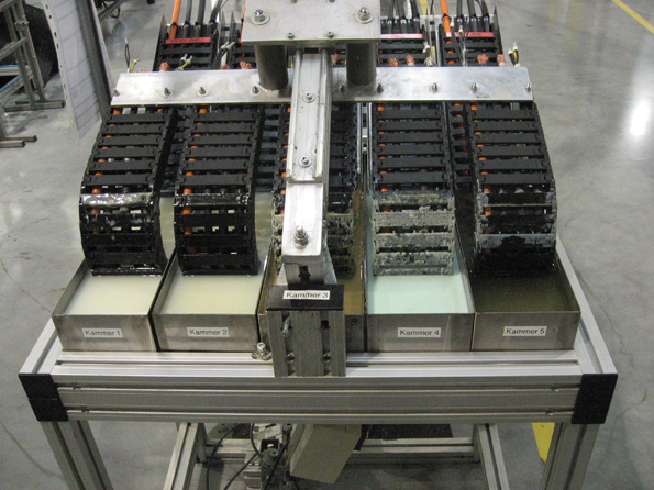

Cable makers frequently do life tests of their motion cables while flexing in different chemicals and oils as depicted in this test run by igus inc.

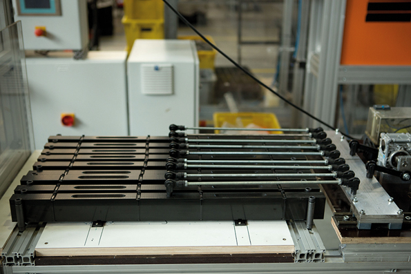

Cable maker igus inc. tests cable jackets for resistance to abrasion by scraping samples millions of times against cable-carrier crossbars. Motion cables frequently see deployment inside cable carriers .

Thus, the failure mechanisms associated with numerous flex cycles are well known. But industry standards for cables tend to ignore these mechanical qualities. The primary focus of standards promulgated by bodies such as UL and CSA is fire safety. These cable tests typically don’t consider lengthy repetitive use.
For example, consider UL 1581, a cold-bend test. Here, cable soaked at a cold temperature is bent around a mandrel, only once. The cable then is returned to room temperature and straightened. It passes the test if there are no cracks in any of its insulation layers. Similarly, the UL 1582 test covers the flexing of shielded cords. It runs 15-ft lengths of cable over two pulleys, but it stops after only 15,000 cycles. The 2007 version of the NFPA 79 electrical standard for industrial machinery is the first version of that code to call out motion cables as a special class and provides guidelines for the construction of a motion cable. But it falls short on outlining mechanical performance criteria and which tests to perform.

Examples include a rolling flex test. Typical rolling and torsional flex (twist and flex) testing entails pulling the cable over a wheel and twisting it 360°. The portion of cable between the grip and the wheel is the part that undergoes twist. A weight hangs on the cable as it twists. One cycle comprises a 90° twist in each direction. Tests typically run at a rate of about 30 cycles/min.
Similarly, the bending flex (tick-tock) test is based on a mil-standard procedure. It keeps one end of the cable stationary while another point in the cable bends around a fixed object. One complete cycle of this test consists of having the cable first flex 90° over a nylon block, then back to neutral, and finally flex backward 90° over another nylon block. A weight hangs on the cable as it flexes. One cycle completes every few seconds.
Finally, cable makers have also adapted standards aimed at ensuring that wiring resists abrasion. The type of abrasion of most interest for motion cable is that which happens when cables move around in cable carriers where they may experience rubbing abrasion, pinching, and twisting. UL typically tests cables for abrasion (as in UL 719) using emery cloth dragged across a sample cable at a specified force for only 5,000 cycles. Cable makers devise similar tests, which, of course, run into the millions of cycles.
