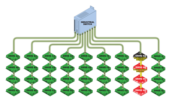

Best-practice daisy chaining In this setup, if one drive fails, only three others go offline with it.

• Use best practices when daisy chaining drives to maximize communication speed and minimize communication breakdowns. Some drives support daisy-chain communications to other drives. It lets designers use fewer network switches and less cabling to connect drive controls. But daisy chaining can slow communications, because each link in the chain must process all signal packets going through the network. Each link must also check to see if signal packets are addressed to it, forwarding or processing packets when applicable. Another issue is the survivability of the network should one communication line or device fail. Take heed, as all drives connected downstream either kind of failure point will cease communications in daisy-chained networks. To minimize the impact of failures, limit the number of drives in any daisy chain to a number appropriate for the application’s network-response requirements and the risk associated with a single device’s failure.
• Weigh the cost of installing all the drives against the safety and financial risks if part of the network shuts down. For example, a factory with 36 drives maintains fast response time and is unlikely to shutdown completely if drives are connected in nine sets of daisy-chained foursomes.
