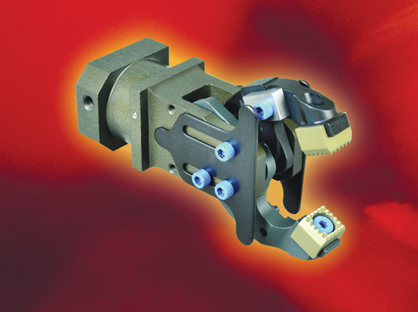

G11 is a new high-temperature option for Series GRM clamps, which are used in hot-forming applications. GRM Clamps with the G11 option include replacement of urethane-based components with all-metal components, high-temperature seals and lube rated to 392°F (200°C), and ceramic-coated tips that minimize thermal transfer from the heat source to the clamp.
The clamps, designed specifically for handling sheet metal in stamping/fabricating press applications, come in three sizes, 13 jaw styles, and numerous jaw openings. The clamps are field-repairable in a matter of minutes using only metric hex wrenches.
