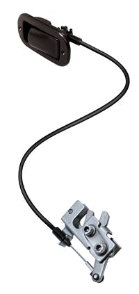

A rotary latch system consists of an actuator, the black plastic lever a person uses to activate the latch in the system shown, the cable that connects the actuator to the latch, and the latch itself.
Typically, a rotary latching system consists of three main elements: the rotary latch itself, the actuator (the interface with user), and the cable which connects these two components. For example, one of the most common everyday uses for a rotary latch is to remotely open the hood of car. In that application, a mechanical lever (the actuator) is activated from the driver’s seat. It connects via a routed cable to the latch in the hood. By pulling the lever, the rotary latch is triggered, allowing the hood to be opened remotely.

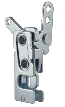

Single-state rotary latches provide a secure way of simply closing a door or panel. Two-stage latches provide increased security by adding secondary latching position which helps prevent false latching.
Another important feature to consider when choosing a rotary latch is whether a single or double rotor is required. Most rotary latches are single rotor, with only one rotor engaging the striker. Double rotor latches however, tolerate misalignments and offer even greater strength than single rotor versions, allowing them to withstand higher working loads. Additionally, rotary solutions can have a built-in bumper that traps the striker between a rubber bumper and the rotor. This eliminates noise and vibration caused by normal operation
Rotary latches with multiple triggering options, such as this R410 Dual Trigger series from Southco, give designers several points of actuation, allowing the latch to be triggered by two independent actuators.

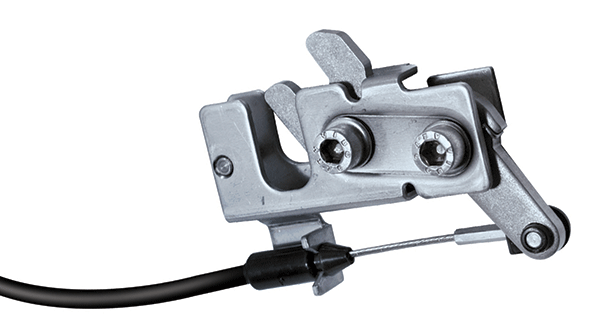

End fitting options offer a high degree of flexibility and enables rotary systems to be easily added into existing designs where there may already be an actuator in place. Many manufacturers offer a range of cable end fittings—barrel, L, Z, eyelet, ball fitting, and bare cable are among the most common.
Cables can connect to the latch with one of several possible end styles—one or more of which should suit the application. They include barrel, L, ball, Z, eyelet, and threaded fittings.
Barrel fittings are compact and easily attach to any actuator, while ball fittings can be attached to actuators as well as rotary latches. L fittings are designed specifically for rotary latches and must to be used with a retaining clip, which eliminates metal-on-metal contact. Z fittings, on the other hand, can be used without a retaining clip, but they do not offer a high level of vibration resistance. The eyelet fitting is designed to accommodate round hardware such as a cylindrical mounting pin. for applications where the cable will be threaded through a hole and have a set screw to tighten down on, bare cable is often the best option.
