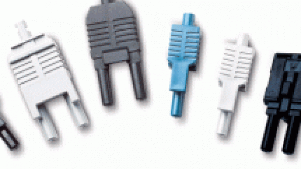

Terminating fibers
Typically, it takes more time to terminate glass fibers than to connect twisted-pair wire because these fibers require end polishing and epoxy. The relatively large 1-mm polymer core in POF, however, makes this kind of fiber much easier to handle. Today vendors offer connectorless and crimpless style connectors that let POF cables terminate more easily than shielded twistedpair cables.
Connectorless transmitters and receivers have 650-nm fiber-optic components that work with unconnectorized POF that needs no end polishing. The user simply cuts the fiber to the desired length, inserts it in the active component ports, and tightens a built-in locking mechanism. Another design uses a simple, snap-together concept that eliminates the need for crimping, thereby greatly reducing labor and tool costs as well as potential yield loss caused by installation errors.
